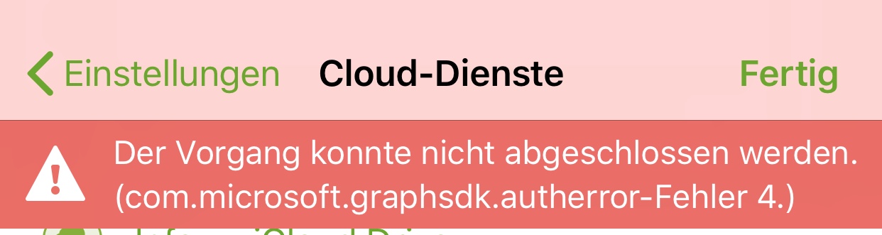

Same issue here.
The connection “lost” its credentials.
And if I try to set up the connection new, Microsoft authentication says that “this browser is not allowed to access the Ressource”
(See screenshots)
So the iOS app works well, but the OneDrive authentication is broken.
I was able to confirm the issue that “forgotten” sessions (probably happens when you haven’t logged in for a while) can cause issues. However, logging out of OneDrive and then logging back in (inside the Cryptomator settings under “Cloud Services”) worked in my case. Not sure what the “second” issue is all about…

Please go into Cryptomator’s settings (the gear icon at the top right), tap “Cloud Services”, and then “Sign Out” from / “Log In” to OneDrive.
In any case, we’re looking into this issue and work on a fix. In the meantime, the workaround should work in most cases. We’ll also look into the other issue reported by @Michael.
