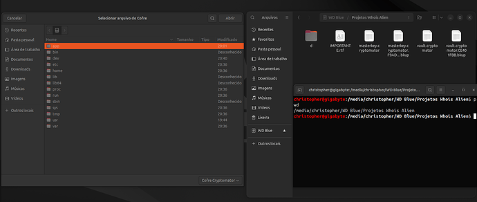

I’m having trouble finding my existing vault folder on my Linux Ubuntu. I currently use Ubuntu and it is not possible to find the existing vault that I use on my external HD. My HD works normally in the Linux file explorer, but finding my vault folder is not possible.
Does anyone know how to solve this problem? I did a lot of research and saw that some people had errors similar to this around 2017 onwards.
I normally used my safe before formatting my system! Before I also used Ubuntu and it worked perfectly, but after I formatted and installed Ubuntu again, I can no longer find the folder!
I tried all possible solutions and none of them were successful! I formatted my system to see if it solved the problem and the error persisted, I tried using Cryptomator from the Flathub store and the AppImage from the official website and the same thing also happens!
On the left side is the file explorer trying to look for the cryptomator vault and on the right side is where my vault is. Note that the /media folder is not found in the root directory when trying to search for the safe in question, on the right side you can see that the data from my safe is present without any problems in the file explorer.

i highly assume you are using the flatpak version. If this is true, see

The problem in your case is not Cryptomator itself, but flatpak isolation. You can give it access to your custom path with:
flatpak override --user --filesystem=/custom/storage/path org.cryptomator.Cryptomator
or just to whole host:
flatpak override --user --filesystem=host org.cryptomator.Cryptomator
