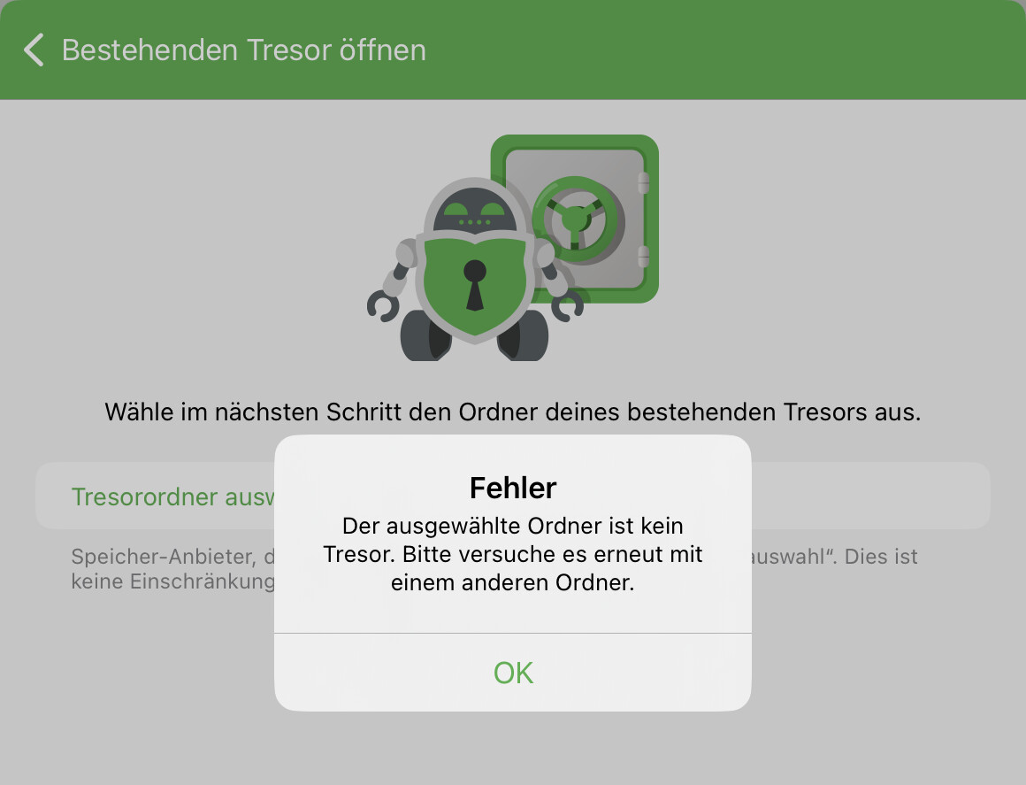

Hi everyone, I am currently moving my data from the cloud to my NAS. I have already established a connection via smb between my iPhone/iPad and my NAS. However, when I select a vault on my NAS in the Cryptomator app, I only get this error message: “The selected folder is not a vault. Please try again with another folder.” What could be the problem?
