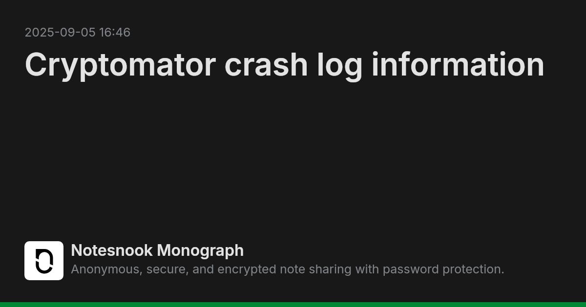

I did a little research for you and came up with some useful information including how to remount your vaults after a crash without having to reboot Linux.
It’s a link to a note that contains information about how to increase the log detail and how to enable that so you can capture the most debug information possible and also you can try switching between fuse and web dav and see if that helps or makes a difference and it includes the location of the log files and you can open a separate terminal window and look at the logs while cryptomator is running.
