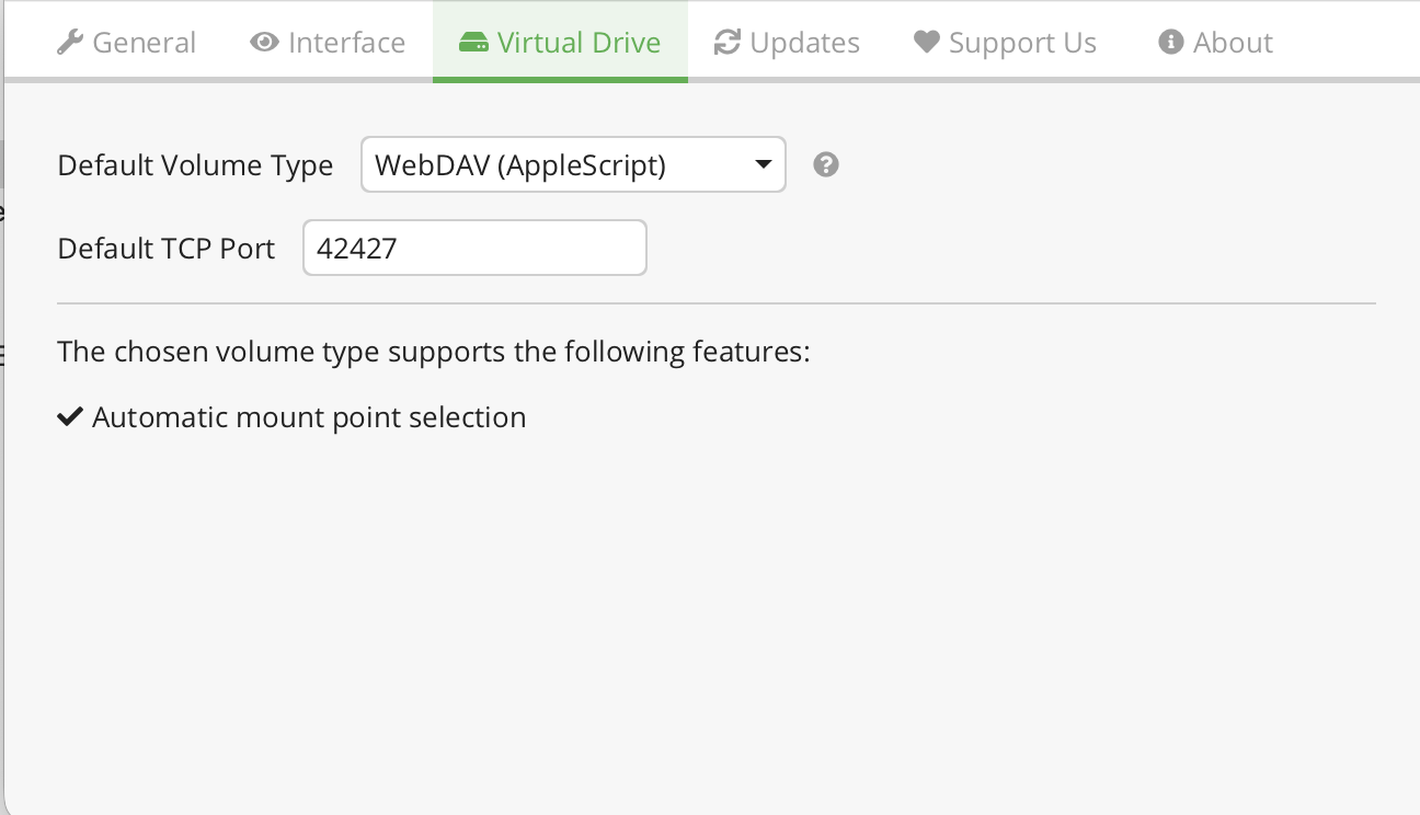

Switching to WebDAV seems to resolve the issue but I read everywhere on the web that WebDAV is a mess, so I’m not very happy with that solution.

When there is no FUSE-T, I do use WebDAV, but it actually causes the exact same freeze issue if mounted via Finder.
I suspect this is a network-related deadlock issue. FUSE-T can’t solve this problem because it essentially mounts the filesystem using NFS, which is still network-based. I guess the network requests of OneDrive’s FileProvider (for downloading offloaded On-Demand files) and the loopback network requests of the network-based FS are waiting for each other, causing a deadlock. These codes may run at the kernel (extension) level, which is why reboot is forced sometimes.
I don’t think anyone other than Apple (and possibly Microsoft) can address the issue. Best solution will be mounting Vaults using the FileProvider API, but devs are apparently unwilling to implement this as corresponding GitHub issue has been stale for years.
As others have mentioned before, the best way for users to avoid this problem seems to be requesting OneDrive to always keep vault files locally, which does reduce the chance of Finder freezing, not a perfect fix as I still encounter the issue sometimes.
