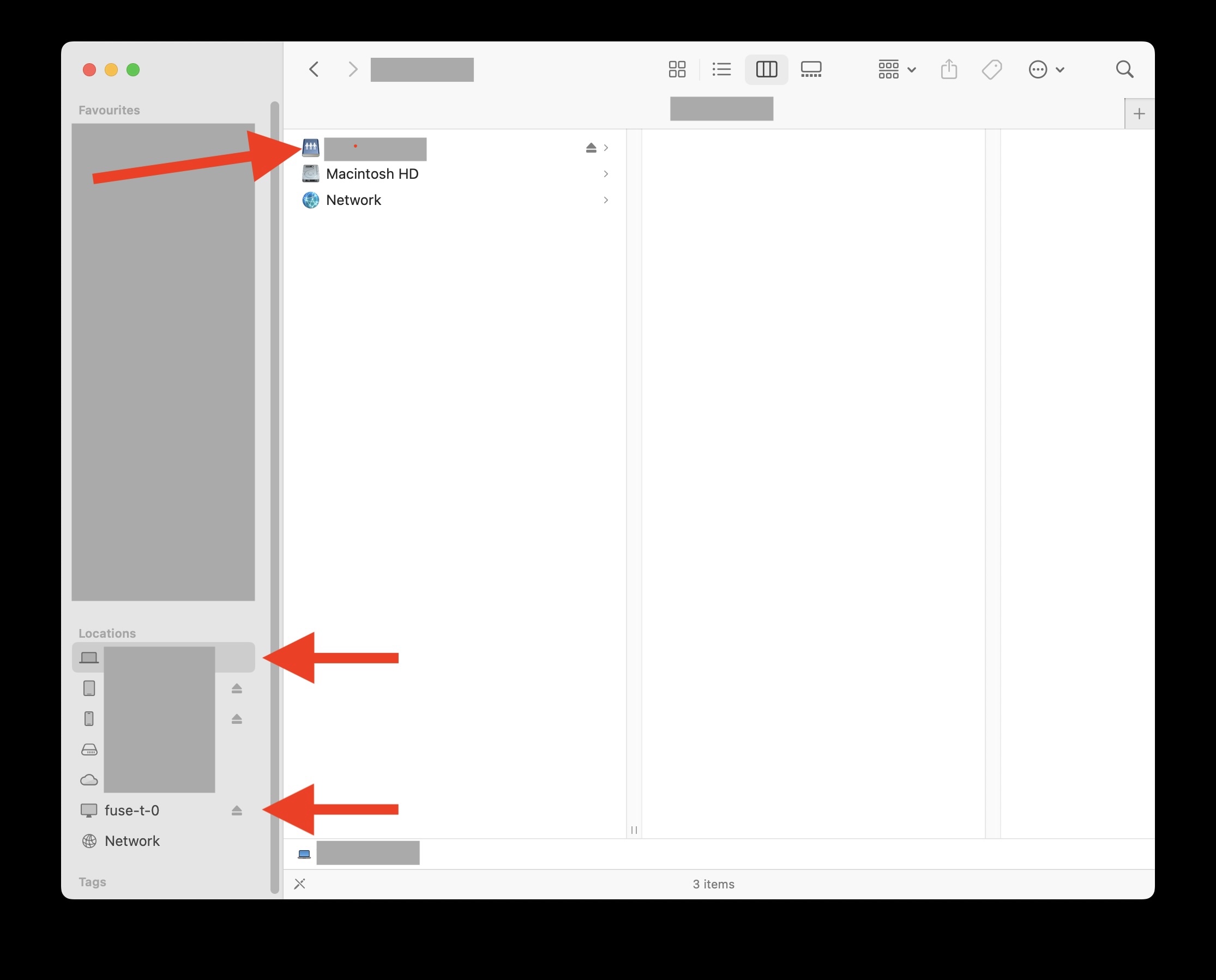

If you have a new MB Air, is it a SILICON or INTEL chip-set? If it is with Silicon, Cryptomator recomeds to use FUSE-T.
But independent of the VAULT type, you should be able to find it when clicking on your computer. You should also be able to see it when clicking on the FUSE-T “virtual volume” which appears after unlocking the vault:
