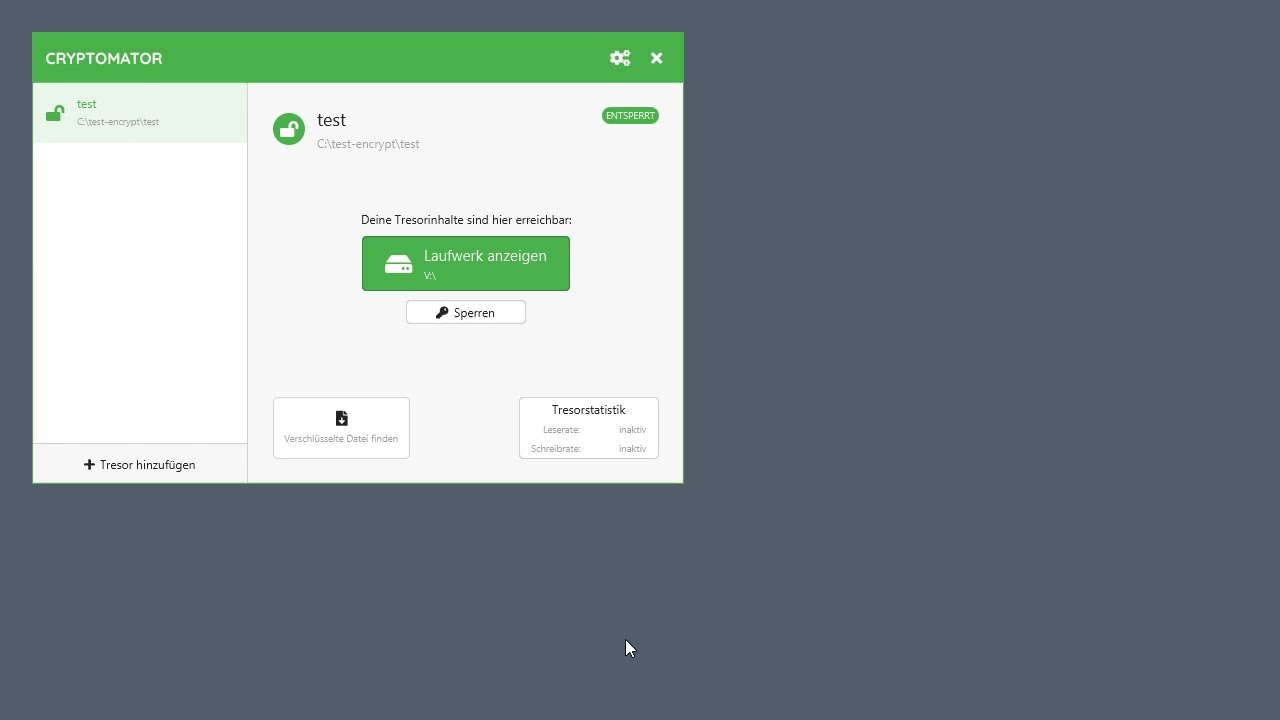

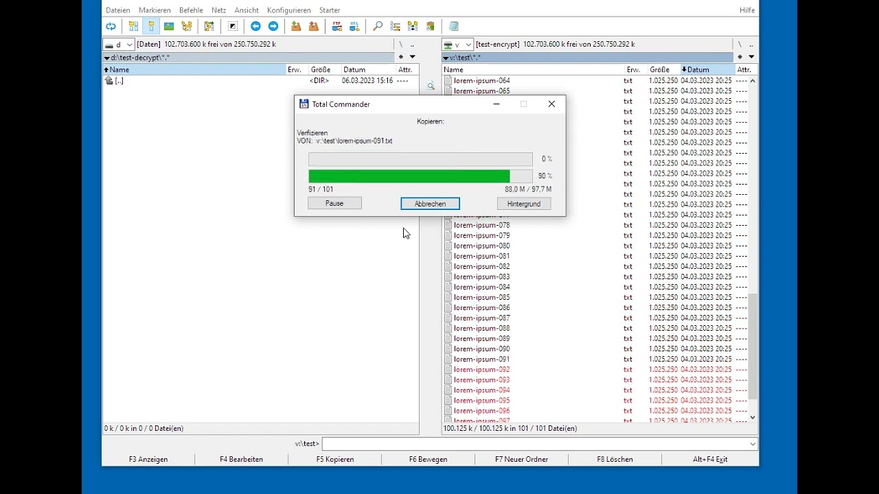

little screencast to show the problem (without sound):
sometimes it is difficult to reproduce the error, sometimes it is possible to copy 10,000 files without there being a problem, on the other hand it can also occur frequently. I can reproduce it on different machines, but I can’t pinpoint when and why it happens.
Update:
It’s a decryption problem, there are no errors when encrypting. When decrypting, it doesn’t matter whether you work with copying or moving. It also doesn’t matter if the cmd copy or move command is used or the file explorer or another tool.
The problem does not occur with smaller files (e.g. 1 kb).

And then I did the Total Commander copy/verifying again from inside the vault to a place on the same SSD outside the vault.
And here we go. I got a difference notification nearly immediately for the 2nd MOV file, and the 5th, and then I aborted. I started again and this time it was MOV file #41,#55,#64,#66. All other files were fine.I clicked “ignore” every time an error came up and waited til the copy process was done.
I checked the difference between the files in and outside the vault of the mentioned MOV files with a MD5 checksum tool (Checksum Control Portable)
All checks showed identical MD5 hashes.
And all file pairs had the exact same amount of Bytes
I then did a copy/verifying of all these files with no cryptomator interaction at all, just from one place on the SSD to an other: no errors
Then I switched the volume type from WINFSP to WinFSP (local drive): Total Commander again reported copy errors for some other MOV files (all others ok), but again the MD5 hashes and amount of bytes were identical between the files.
So from my point of view, I can reproduce the behavior of Total Commander together with WinFSP and larger MOV files, but I can not reproduce any loss of data. Looks to me like a false error of Total Commander. Unfortunately I do not have a clue what might cause there error messages.

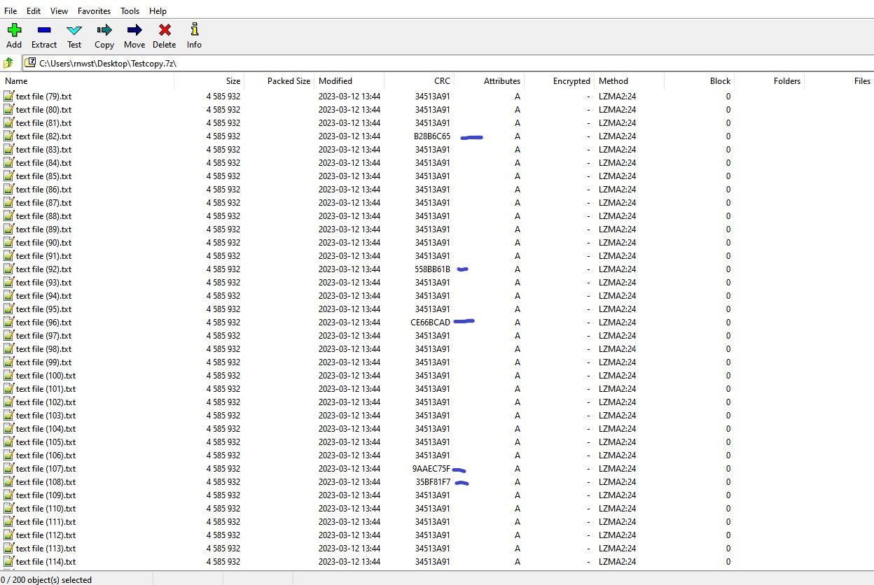

I have reproduced this data corruption with version 1.7.1 (on a Windows 10 Pro laptop). I have NOT been able to do the same with version 1.7.2, but I still believe this critical issue is important enough to look into in order to understand what causes it with version 1.7.1 so that we can avoid it in the future.
Here are my steps to reproduce:
A) Identical test file creation:
  • Created an empty .txt file
  • Pasted in it a lorem-ipsum text paragraph multiple times so that the file slightly exceeds 1MB size (was about ~4.5MB)
  • copied the file(s) multiple times 1 → 2 → 4 → 8-> … → 200+ so that I got 200+ identical files
  • selected all files (Ctrl-A) and right-clicked and selected rename, typed a file name and pressed enter to auto-rename all files incrementally
  • windows auto renamed the files like this: file (1).txt, file (2).txt up to file (200).txt (OP said incremental naming MIGHT play a role, I haven’t tested with random file names)
  • selected all 200 files and 7zipped them (right click → add to filename.7zip) in order to verify that no data corruption has occurred up to this point
  • All CRC match as expected
B) Cryptomator:
  • Installed cryptomator 1.7.1 along with its winfsp on Windows 10 Pro
  • Chose winfsp in cryptomator settings and set application to english and restarted laptop
  • Created a vault and unlocked it
  • Copied in it the 200 identical text files that had been created previously
  • Again, selected all 200 files (in the open vault this time) and 7zipped them (right click → Add to filename.7zip) to verify that no data corruption has occurred yet
  • All CRC match here too as expected, no problems yet
C) Data corruption:
  • Selected all 200 text files from the vault and copied them to a new folder on desktop (by right-click dragging)
  • Selected all 200 text files that were just copied to desktop and 7zipped them by right-click → Add to filename.zip
  • Opened 7zip to check CRC codes: around 15-20 files have been unexpectedly altered during copy
Edit: More than 30 files we altered, screenshots only show approx half the files.
Reminder: Data alteration / corruption was only reproduced with version 1.7.1, not 1.7.2. But since this is reproducible please look into it to avoid this critical issue in the future.
